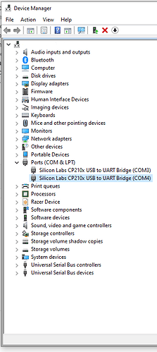

Hi again,
As you can see, I’ve got both of the devices recognized and visible on the device manager screen. The converter connected to “COM3” and it is my “FPV Radio Telemetry Air Module”. The COM4 is the ground control piece. This one is for 915MHz telemetry modules.
Quick summary: 2 weeks ago, I accidentally reset the Ground Module(COM4, in this screenshot), and that led to the unpairing of modules. Now, Air Module(COM3, in this screenshot) has the default settings and I can’t connect to it.
If you check the Mission Planner Screenshots, I cannot connect to the COM3 device, it fails.

COM4 Port which is my ground module has the properties visible in this screenshot.
The 433MHz version next to 915MHz version.
So, can I say that my issue with the telemetry being not recognized by my PC is over and my current issue is I can’t make the Mission Planner to see the device or something?
