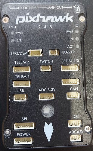

The Original PixHawk that came with the Kit
had an issues when i was connecting / reconnecting the mini usb and resulted in it’s connector breaking and falling inside the unit
I posted a message Pixhawk replacement - Drone Talk - Drone Dojo (dojofordrones.com) asking if anyone knew where in the UK to get a new one, i got one in the end which to me seemed to fit the bill.
This one has this quoted on the side

What is the firmware you loaded?
The naming conventions used can be confusing. There was a discontinued ‘PX4’ autopilot, and Holybro sells a ‘Pixhawk 4’.
The “PX4” logo on the side refers to an alternative firmware offered by Lorenz Meier in Zurich. We use ardupilot in this course. But this controller should accommodate ardupilot. You can always confirm with where you bought it (Unmanned Tech?).
The telemetry indicates you have configured it for ‘OCTA’… octo? Run through the setup once again ensuring you are using the latest ardupilot firmware, configure for ‘QUAD/X’. Then in battery monitor use HW version ‘Pixhawk’. Using the incorrect setup might account for the GPS and motor issues.
