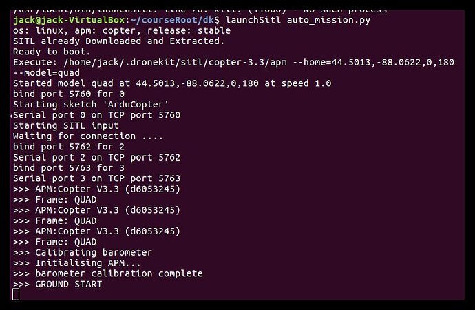

When I run it I get the following, where it just stops -

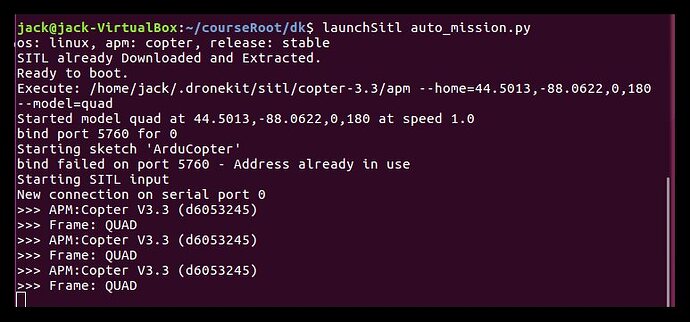

I have to Crtl-C to get out, and when I try again I get a slightly different result

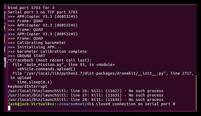

The error message after Ctrl-C was the following. It refers to line 93 which is:
vehicle.commands.upload()
I think there are two problems here:
  1. “Port 5760 Already In Use”
    When you have to Ctrl+C from the script, you are leaving the dronekit-sitl program running on port 5760 in the background. Then when you try and run it again, a new dronekit-sitl instance will try to create and utilize port 5760, but since it is already in use, it cannot create from scratch.
I am going to update the suggested code for ‘launchSitl’, but to avoid this issue going forward, I would suggest added these lines to the beginning of your launchSitl script:
kill -9 $(ps -eF | grep QG | awk -F' ' '{print $2}') > /dev/null 2>&1
kill -9 $(ps -eF | grep ardu | awk -F' ' '{print $2}') > /dev/null 2>&1
kill -9 $(ps -eF | grep mav | awk -F' ' '{print $2}') > /dev/null 2>&1
kill -9 $(ps -eF | grep apm | awk -F' ' '{print $2}') > /dev/null 2>&1
This code at the beginning of launchSitl will close down any of the programs that use the ports needed to launch a new SITL drone.

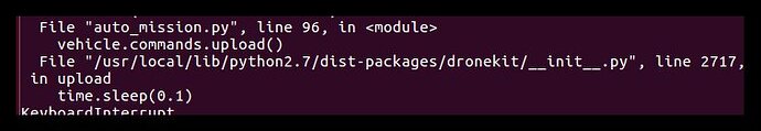

That was a good idea. It appears to get hung up with the upload command, consistent with the report from the second message above regarding line 93:
I waited about 10 sec before I bailed.
:ok_hand:
Hmmm, so it is struggling uploading commands to the drone. Perhaps there is a problem with the dronekit-sitl (Version Copter-3.3) copter that the launchSitl script is using.
Lets try launching the sitl copter (Version 3.5.5) from the ardupilot directory. If it works, than the issue had something to do with dronekit-sitl, if it doesn’t work then our issue is not related to the sitl vehicle.

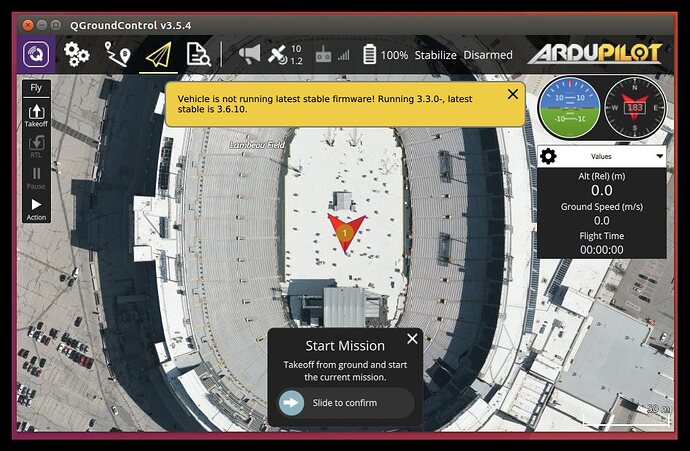

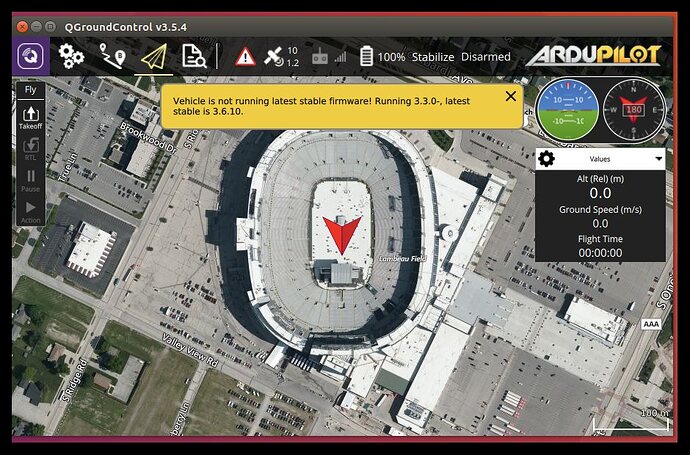

Didn’t seem to work, yet a few more status statements were revealed.

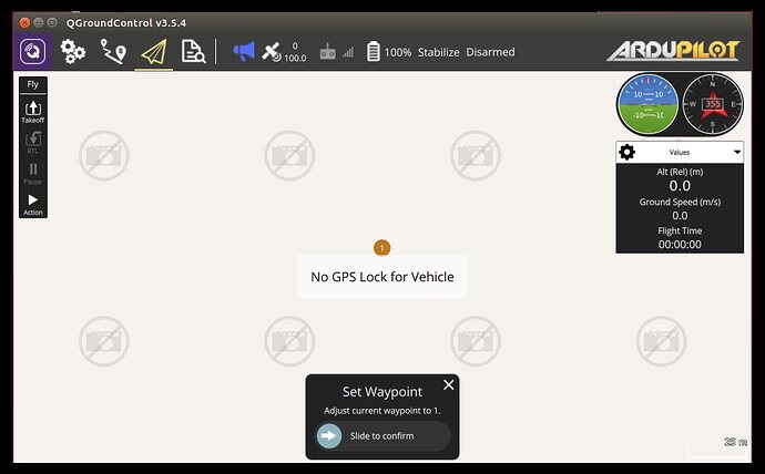

And something happened to QGC…
By the way, I tried to execute a few of the other programs first. They now won’t arm.. What am I missing here?
If an alternative configuration is possible, I am certainly willing to re-install everything to test it.
Jack, I believe running the ArduCopter from the ardupilot/build directory requires a much longer time to arm compared with the dronekit-sitl vehicle. This could explain why even location_based_movement.py wasn’t working for you when you tried launchSitl with the new SITL vehicle.
Try letting it run for a really long time, like 5 minutes, to see if it will 1.) become armable and 2.) If the commands will upload for auto mission.
