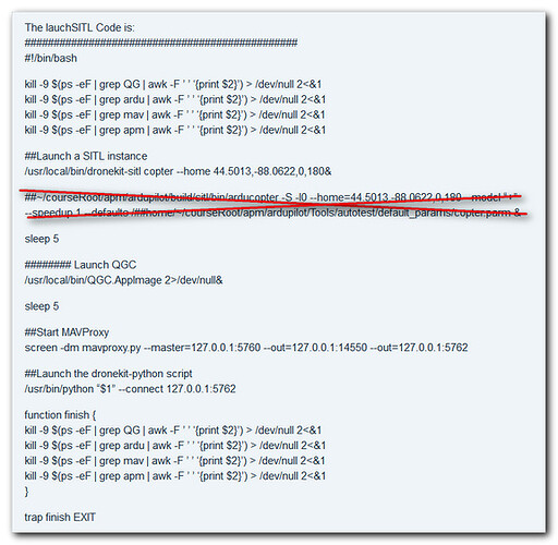

Thank you for the reply Jax.
I edited the launchSitl program as per your screen capture.
And it seems no matter what happens, the dronekit link always times out…
--------------------------------------- lauchSitl---------------------------------------------

Traceback (most recent call last):
File “basic_template.py”, line 63, in
vehicle = connectMyCopter()
File “basic_template.py”, line 26, in connectMyCopter
vehicle = connect(connection_string,wait_ready=True)
File “/usr/local/lib/python2.7/dist-packages/dronekit/init.py”, line 3166, in connect
vehicle.initialize(rate=rate, heartbeat_timeout=heartbeat_timeout)
File “/usr/local/lib/python2.7/dist-packages/dronekit/init.py”, line 2275, in initialize
raise APIException(‘Timeout in initializing connection.’)
dronekit.APIException: Timeout in initializing connection.
gustavo@thinkpad-t430:~/courseRoot/dk$

gustavo@thinkpad-t430:~/courseRoot/dk$ python connection_template.py
Starting copter simulator (SITL)
SITL already Downloaded and Extracted.
Ready to boot.
CRITICAL:autopilot:APM:Copter V3.3 (d6053245)
CRITICAL:autopilot:Frame: QUAD
CRITICAL:autopilot:Calibrating barometer
CRITICAL:autopilot:Initialising APM…
CRITICAL:autopilot:barometer calibration complete
CRITICAL:autopilot:GROUND START
However when I tried running python basic_template.py, it never sets the mode to GUIDED. Dronekit doesn’t seem to be communicating consistently with the Sitl or sim_vehicle???
gustavo@thinkpad-t430:~/courseRoot/dk$ python basic_template.py
Ready to boot.
Waiting for vehicle to become armable.
Vehicle is now armable
Waiting for drone to enter GUIDED flight mode
At this point, I am wondering, if I should get my money back for these courses, I am not sure where the problem lies, but it is definitely over my head…
I know from experience it can be frustrating. But one thing I can say is I was always able to get through it.
I presently test rather complicated missions with a sitl.
I can offer this idea: let’s start from scratch and write down each step and I will do it with you.
We can use python2 or python3. Python2 is deprecated, but Caleb claims python3 runs into issues with ros. So normally I use python3 but for a ros environment I am using python2.
Let me know and I will write down the steps.

while vehicle.mode!=‘GUIDED’:
print(“Waiting for drone to enter GUIDED flight mode”)
print(" Mode: %s" % vehicle.mode.name)
time.sleep(1)
print(“Vehicle now is GUIDED MODE. Have fun!!”)
vehicle.armed = True
while vehicle.armed ==False:
print(“Waiting for vehicle to become armed”)
time.sleep(1)
print(“Look out! Virtual props are spinning!!”)
vehicle.simple_takeoff(targetHeight) ## meters
while True:
print(“Current Altitude: %d”%vehicle.location.global_relative_frame.alt)
if vehicle.location.global_relative_frame.alt>=.95*targetHeight:
break
time.sleep(1)
print(“Target altitude reached!!”)
return None
######### MAIN EXECUTABLE ########
arm_and_takeoff(10)
END OF SCRIPT
------------------------------ dronekit is causing a system error, it never actually switches to GUIDED Mode, the system keeps reporting the status as STABILIZED, and then the motors go to “ARMED” and boom!! a CRITICAL ERROR pops up more than once… --------------
gustavo@thinkpad-t430:~/drone/dk$ python basic_template.py
Ready to boot.
Set Vehicle.mode = GUIDED (currently: STABILIZE)
Mode: STABILIZE
Mode: STABILIZE
Mode: STABILIZE
Mode: STABILIZE
Mode: STABILIZE
ERROR:autopilot:ARMING MOTORS
Mode: STABILIZE
Mode: STABILIZE
Mode: STABILIZE
Mode: STABILIZE
Mode: STABILIZE
Mode: STABILIZE
Mode: STABILIZE
Mode: STABILIZE
Mode: STABILIZE
Mode: STABILIZE
ERROR:autopilot:DISARMING MOTORS
Mode: STABILIZE
Mode: STABILIZE
Mode: STABILIZE
Mode: STABILIZE
Mode: STABILIZE
Mode: STABILIZE
Mode: STABILIZE
Don’t know, runs ok with me. Can’t see the true code formatting, but assume indents are ok.
The only difference I removed ‘APIExcpetion’, but I wouldn’t think that matters.
May I ask you, which version of DroneKit are you running?
gustavo@thinkpad-t430:~$ pip freeze | grep -i drone
dronekit==2.9.2
dronekit-sitl==3.3.0
gustavo@thinkpad-t430:~$ pip freeze | grep -i mav
MAVProxy==1.8.49
pymavlink==2.4.29
Same as yours. If you want me to run your code, send it to jack-dronedojo@moremobileprivacy.com.
