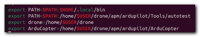

No need to worry about that. Make sure the last lines look like:
Note: I used ‘drone’ as my drone folder in-lieu of course root.
Some of these just provide shortcuts for getting around and aren’t even required to run the drone code.
