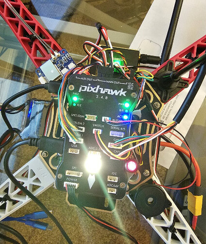

hi,
Im at the course “connect drone to MP via internet only”
I am able to connect using the MP interphase but unable to do it via scripts.
read an older blog here but could not make it happen.
I also followed the steps in the youtube video “make your own pixhawk rpi dorn in 36 minutes”.
following the steps in the youtube video, I did change the RPI config tool ad also edited the boot/config.txt file.
when I connect the rpi to power, the pixhawk does get power too.
this is what I get with /dev/ttyAMA0 (youtube video)
pi@raspberrypi:~ $ mavproxy.py --master=/dev/ttyAMA0 --baud 57600
WARNING: You should uninstall ModemManager as it conflicts with APM and Pixhawk
Connect /dev/ttyAMA0 source_system=255

more info:
  • changing the baud rate, no luck,
  • I am in a windows laptop,
  • used the easy raspberry pi imager
  • the RPI does connect to wifi because I can see it in the advanced ip scanner

Jax,
I like the article you shared, I have followed up the steps and still no luck:
  1. “Wires”
    Double checked that the wires are connected correctly from Pixhawk to RPI,
  2. “SW loading”
    run the commands on step two again
  3. serial interface
    already enabled serial port in RPI as step 3.
    Would you like a login shell to be accessible over serial? NO
    Would you like the serial port hardware to be enabled? YES
  4. bt overlay
    already confirmed configuration in boot config file
  5. mavproxy statement
    used the same statement as the course video,
  6. baud rate
    attempted multiple baud rates, from minimum to max, no luck, heres a couple examples
  7. not sure what to do here but I think we are using serial 2 and we can see is set to MatLink2 and 57600 baud,
  8. COM port,
    not applicable here since we are using IP?
couple notes:
-If I power the RPI, the pixhawk does power,
-Using RPI imager,
-My mission planner arducopter is newer compared to the one shown in the video.
-I am able to connect the Mission planner using USB link, if I tilt the drone, the horizon moves and I can see the map showing my house location.
-I have been unable to power the motors with the RC controller, the manual calibration didn’t work, the calibration through mission planner I think didn’t work.
-all other pins/wires in pixhawk or RPI have been disconnected/connected to make sure no lose cables

My video shows that the pixhawk does connect to MP via USB and not via Internet. Motor Test in MP only makes music in pixhawk but doesnt spin the motors. the battery is connected and has full charge. Confirmed that the motors are receiving charge and are even pulsating a little bit. Checked that the screws are not over-tight, watch this second youtube video:
checked all the cables to pixhawk, so far I believe the pixhawk hates me.
