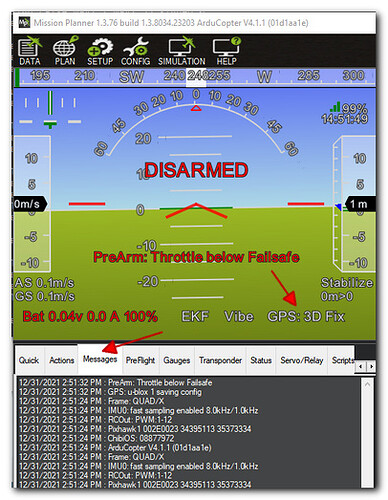

Assuming everything else has been calibrated, you might actually have the ESC calibrated, but just struggling with the pre-arm check. Try powering up again, turn on your transmitter with the stick down. Connect to MP to watch the Messages tab to see what’s going on. Wait 1-5 minutes for the blue/green flashing LED to turn blinking green - this indicates you have “GPS: 3D Fixlock”. If this doesn’t happen you might be in a GPS shadow, so get clear of walls, etc. After you have that you can then try arming and the motors will spin. Always ensure the batteries have sufficient power to push the motors.
Note the “PreArm: Throttle below Failsafe” message which will prevent arming. The MP ARMING_CHECK paramater will allow you to make some adjustments, eg, no GPS.
Regarding the Motor Test, you will get this message sometimes because the %Throttle level to activate the motor was too low. Raise it up to around 10-12 and see if it works.

The following errors were showing on the MP messages:
01/01/2022 09:47:24 : PreArm: Compass 2 not Found
01/01/2022 09:47:24 : PreArm: Check firmware or FRAME_CLASS
For the first two I’ve gone into the setup, as you showed, and removed the compass as a requirement for pre-arming checks:
Hopefully that won’t cause any issues later on. For the 3rd error, had already checked the Pixhawk had the latest firmware, so went to Setup in MP and set the frametype to “X”. That immediately changed the drone’s yellow flashing lights to blue, and the motor beeps became near continuous. I was then able to follow the esc calibration using MP, and did get the happy beeps.
