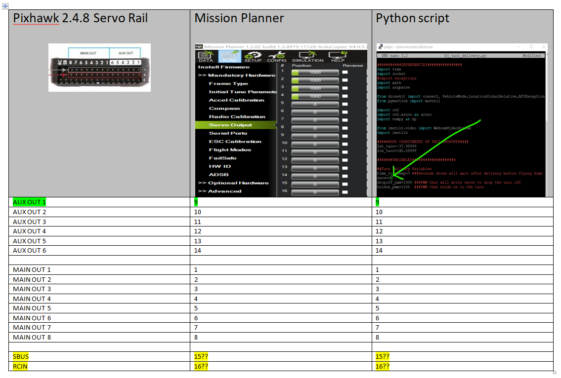

The servo and or control_servo.py work fine now that I’m using ‘Main Out 8’ rather than’Aux Out 1’, on the Pixhawk rail …

I figured it out.
Attached is how I deciphered how to assign correct number/values in the Python Script, so that they correspond to the matching servo rail, i.e.
earlier, I assigned 14 for the servo. Now, I’ve assigned 9, & it works fine.
