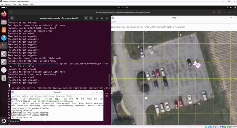

Hello! I have multiple questions regarding rover simulation in the course, simulation logs retrieval, etc. I couldn’t find a suitable place for each of the question, hence, I am posting all here.
  1. The dk folder in the preconfigured VM does not have the rover scripts as seen in the video of smart rover development in the last section of the course. How can I get this? For now, I edited the location_based script to perform my rover simulation.

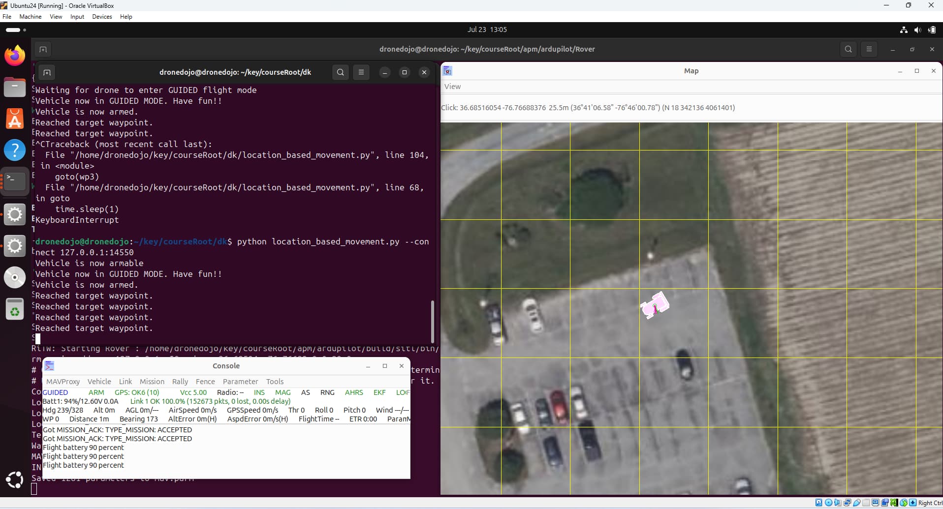

  2. During rover simulation (location_based_movement), my rover keeps getting stuck at some point and does not move further (please see attached image). In the image attached, my rover faces east at the home location. It is meant to go around the parking lot, but it gets stuck while moving eastwards. What is causing this issue and how can it be resolved for a smooth path tracking (waypoint following)?

Hi there,
  1. You can download the repo at GitHub - dronedojo/pidronescripts and in that repo, under dk/rover, there are rover based scripts. You can also use the dronekit section of the rover video https://www.youtube.com/watch?v=paPXfGOhqfo&t=6161s to follow along with writing the scripts
  2. What version of ArduRover are you using? There can be quite significant differences version to version. I would recommend downloading a different version and seeing if the problem goes away. EG from 4.5.3 to 4.3.5. I would also recommend if this is a limitation of the python script or the internal autonomous navigation controllers. Create a mission and upload it via MissionPlanner or QGroundControl, switch it into auto, and see if the problem goes away.
  3. For rovers, it can actually be more difficult to get a perfect simulation of paths. For drone’s it’s more straightforward to simulate. Rovers are totally different. Skid steer vs acumen, turn radius, etc. In my experience, SITL for rover is best just to test the high level script intention, and not for confirming perfect projection of traveled paths.
