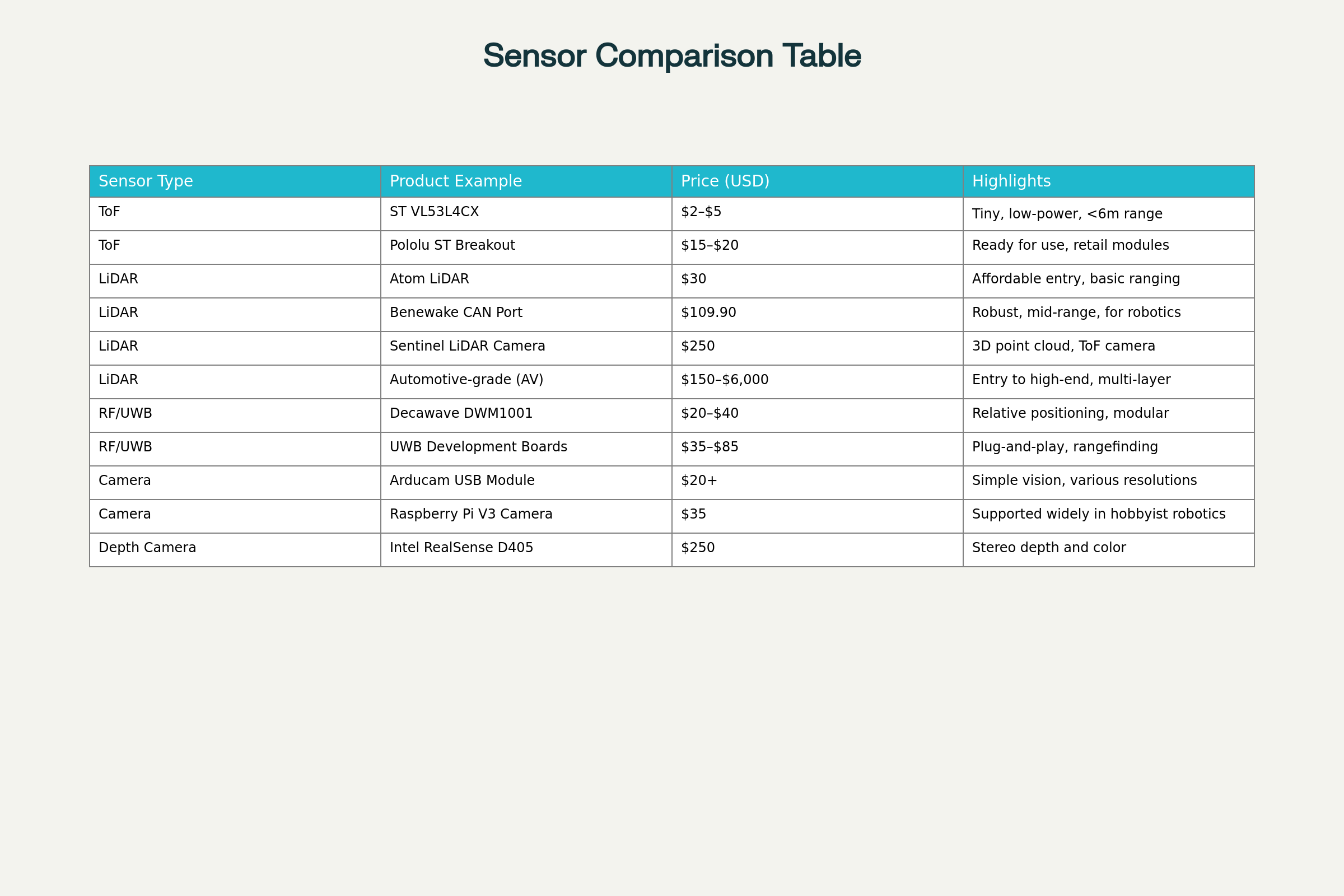

I do not, but my AI response indicates that depending on your specs for accuracy and precision, there are better options such as ToF, Lidar, RF and visual (ie, camera). (I know this is an AI dump, but perhaps it can continue the thread on this topic, especially if you could report any success.)
Setup (untested AI response)
To measure speed and distance between two rover vehicles using sensors like LiDAR, ToF, RF/UWB, or cameras, here’s a step-by-step coding and setup guide for the most typical and versatile sensor, LiDAR, which can be adapted similarly for other sensor types:

Step 6: Adapting ToF, RF/UWB, or Camera Sensors
  • For ToF sensors: Use their SDK or I2C interface to get distance readings similar to LiDAR.
  • For RF UWB: Use ranging modules like Decawave DWM1001; measure time-of-flight to compute distance, then track movement over time.
  • For stereo or depth cameras: Use OpenCV or RealSense SDK to get depth data; detect the other rover and calculate relative distance and speed similarly with frame-to-frame differences.
