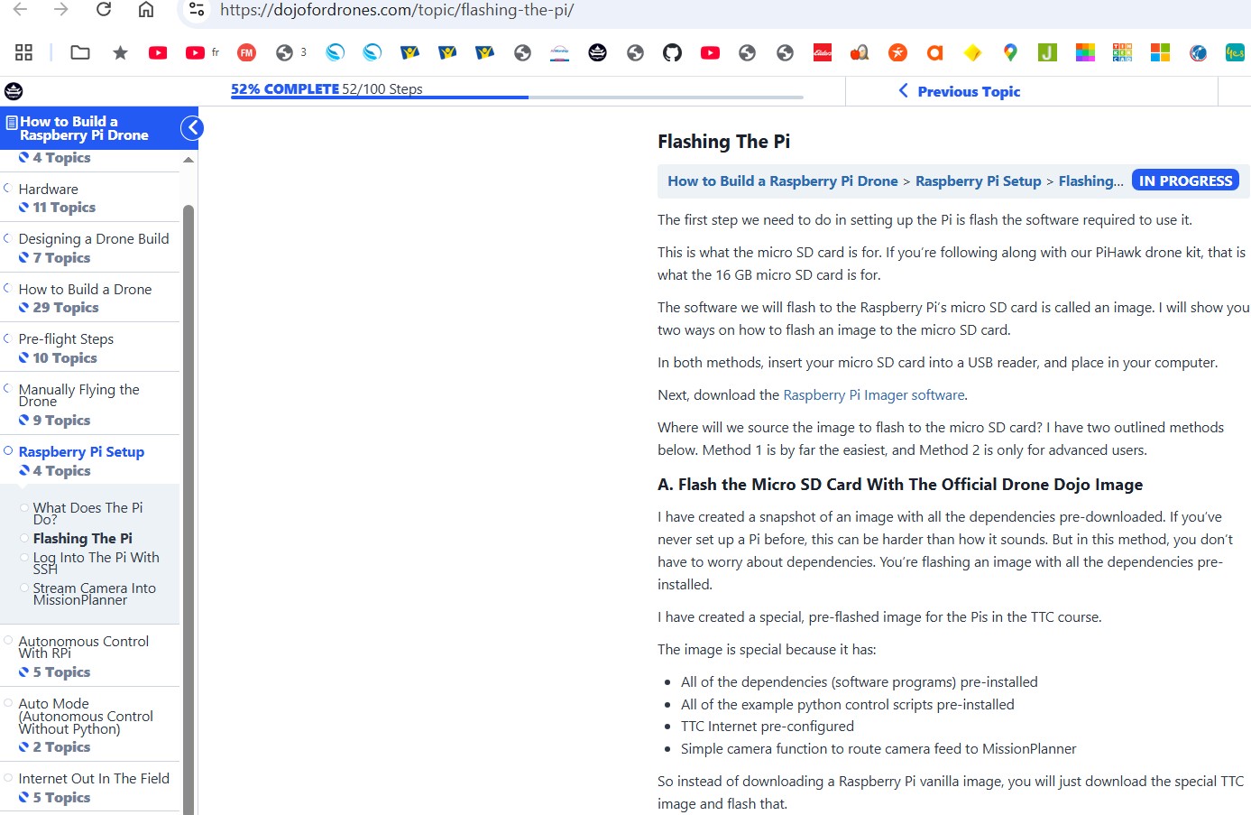

Regarding the attached tutorial:
can this image be used for Raspberry Pi 3 and/or RPI 4 applications, or will it only work for a Nano/the TTC course?
