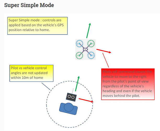

2 Use Simple / Super Simple flight modes
You can program one or more of your transmitter switches to either of these modes which allows for better control regardless of orientation, useful when learning to fly. They will allow control of the drone irrespective of vehicle orientation.
https://ardupilot.org/copter/docs/simpleandsuper-simple-modes.html
With either or both of these options you should be able to gain better control from a distance.
