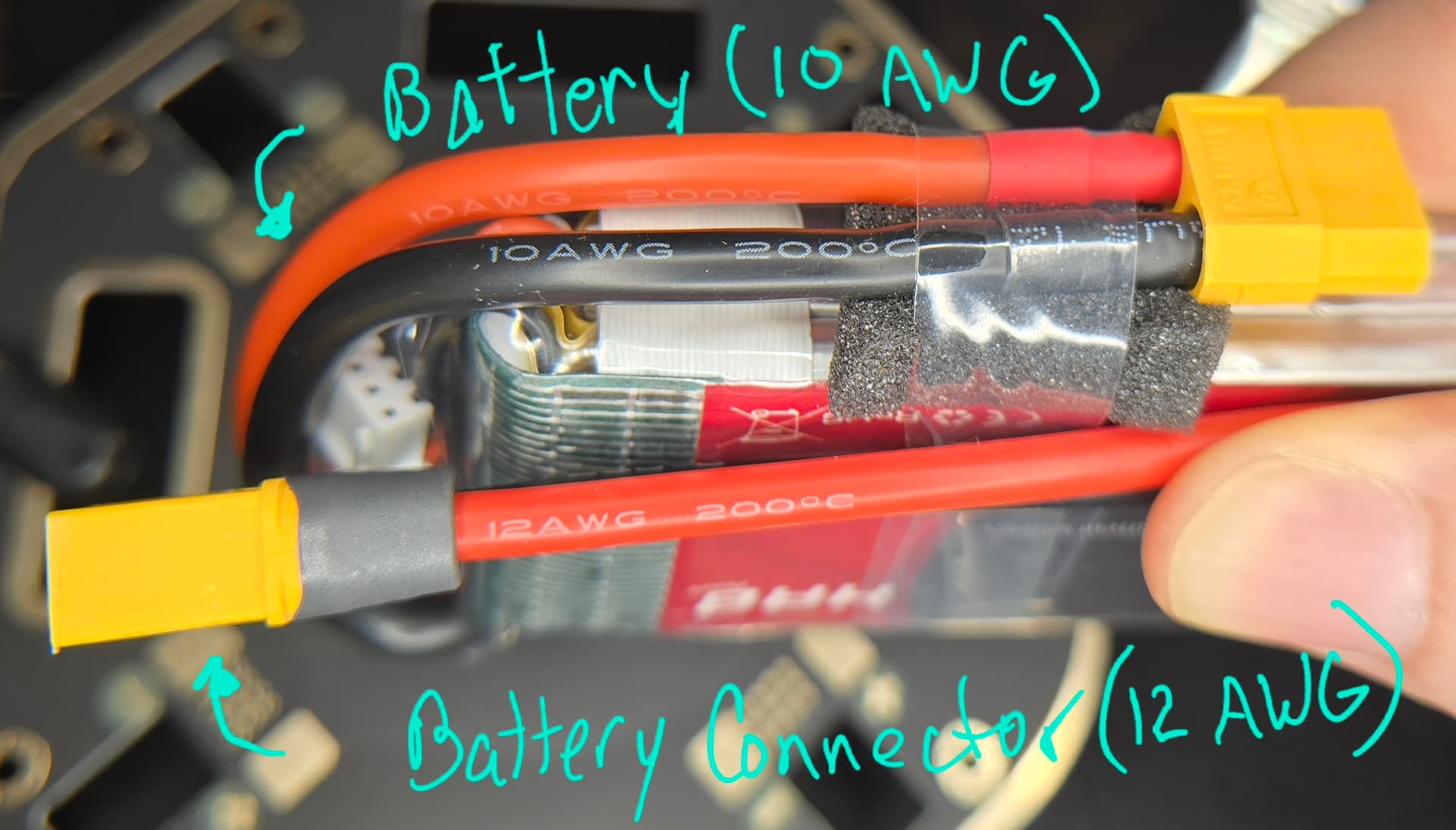

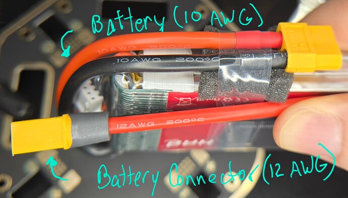

Hopefully you can see the gauge mismatch in the picture. The videos mentioned these gauges should match. Please advise. Thanks!
Put a new connector/wire on the PDB or get a connector adapter.
Thanks, I ordered some 10awg connectors
