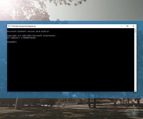

Are you able to pull plug this SD card into a desktop OS and look at the disk allocation? In windows type in “Disk Management” with the SD card plugged in. Look for any un-allocated space.
It should look something like this:
I have found this article to be helpful:
