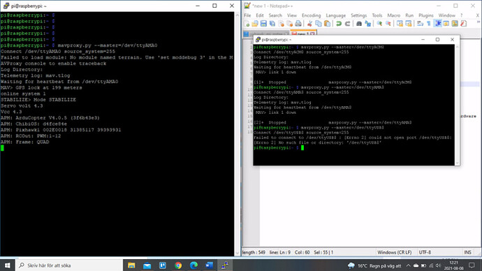

I notice under the boot/config.txt that uart is enabled but i am using an USB, so i changed it but got same result as when the uart was enabled.
the firmware version for the apm2.5 is V.3.2.1
i downgraded the Mavproxy to 1.8.18
MAvproxy 2.4.15
python version that caleb recomends
Forgot to mention, i am using RPi 4
The screenshots are a little hard to read, but it shows it’s connecting, so not sure what the problem is?

sry for the missleading screenshoots, the black screen on the left is from the course, while the small black screen from the right is from my pi 4. So, No it is not connecting. I will uppload better photos

Yes, it is more readable now. It seems you are doing things ok, although I have not tried using the USB.
I am not certain it would matter, but try lower case, so “enable_usb=1”.
