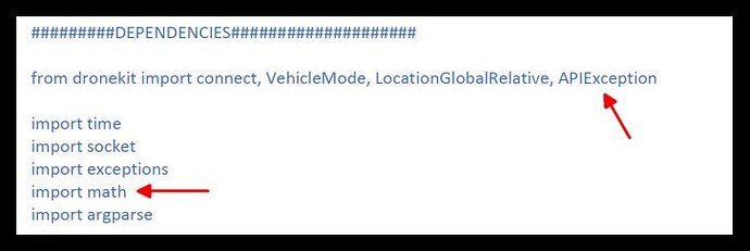

I noticed the dependencies section is incomplete:
Also - perhaps I’m unclear regarding what you did - remove the statement
