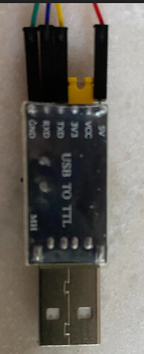

Tried mapping a TF LUNA (Range Finder) using a USB_TTL converter.
I can confirm the sensor is working because:
  1. Red LED on the sensor is on.
  2. I get data being send using Putty serially connected to my PC.
I followed the steps outlined, by mapping TELEM parameters to -F (Serial 5) and did the ttyUSB_LIDAR mapping as per the instructions, even tried connecting another TF LUNA via the I2C port, and neither seems to provide range/distance?
