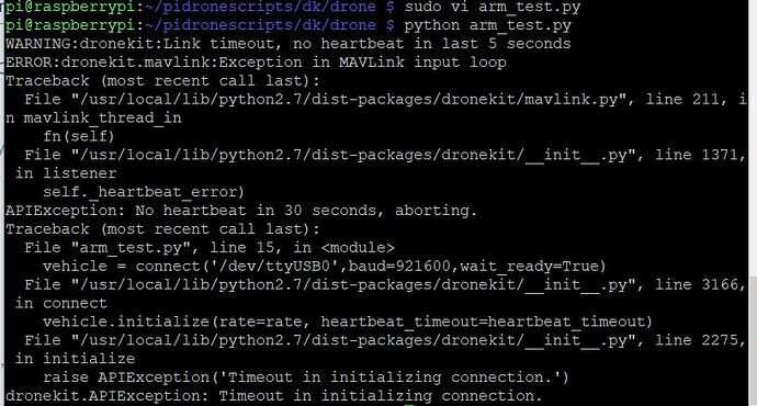

I’m trying to run arm_test.py but it says dronekit has no heartbeat.
My hardware is Cube Orange + Raspberry Pi 4 and they are connected via USB CP2102 FTDI, hence I had to modify the connect code to
vehicle = connect(‘/dev/ttyUSB0’,baud=921600,wait_ready=True)
I tried running mavproxy.py --master /dev/ttyUSB0 and it works just fine which makes me even more confused.
Any help would be greatly appriecated
Not sure. What if you change this statement to :
vehicle = connect(’/dev/ttyUSB0’,wait_ready=True)
